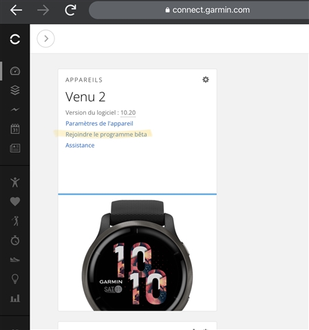

  • You don’t need a pc. Just log on your garmin connect account with Firefox, chrome, safari, on your phone or tablet…
    On the top left corner you should have a square dedicated to your venu2
    you should have something saying ‘join the beta version’
    here is a screenshot made on an iPad (sorry it’s the French version)
