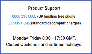

  • Hi Kevin
    If you could give me the most direct number for a repair/replacement it would be very helpful as no amount of resetting, calibrating or cleaning is going to make any difference to me racking up floors before I've even stepped out of bed.
    I'm in keynsham, bristol, UK.
    Thanks
    Mike
