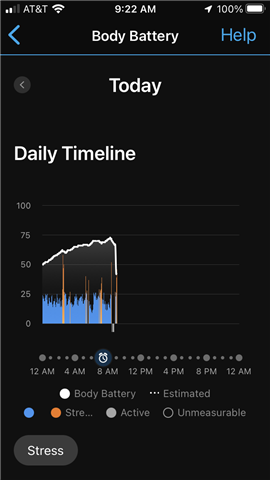

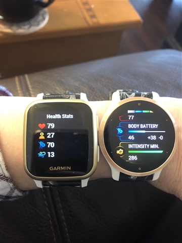

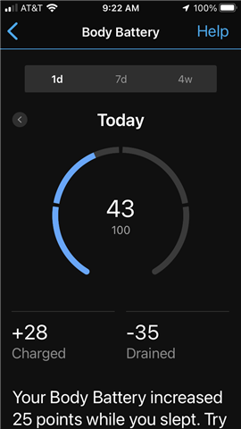

  • Ah ok, yes the grayed out upload works. just to cover all bases I wore them both for the last 24 hours.  I synced them both then took the photo of the two watches side by side.  Just to see if it made a difference I made the SQ the primary watch for the last day but it doesn’t seem to matter
    This first photo was taken at 9:03 just after I synced, you can see they show vastly different stress levels right after syncing which didn’t effect it.  Ever since I got the 2S my sleep scores and body battery has been awful, it mostly shows I have low stress at night instead of sleep stress like the SQ.  I love the 2S but I think the sleep and body battery readings are off.

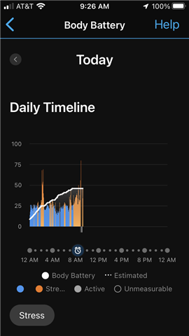

    Here is a photo of the first part of the night:
  • And this is interesting.  I switched the primary back to the 2S and connect now reflects the 2S body battery but appears to be showing the stress readings of the SQ.
  • Because (each of) the watch(es) can take 5-7 days to learn/re-learn your body (see the "My Body Battery Appears to Be Stuck at 5%" section of Body Battery Frequently Asked Questions), there is bound to be some discrepancy when switching your primary tracker often.  I'd like to see what happens when you follow the steps in my last comment after wearing the Venu 2s as the primary tracker for a week.  During this time, there is no need to wear the Venu Sq.  Then, when you follow the steps in my last post, please post the results.

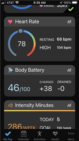

  • Oh, I’ve had my SQ for over a year and my 2S for a couple weeks now.  I had the 2S as the preferred tracker the whole time (only temporarily changed it yesterday) and this has been going on all that time and has never changed.  Here are the pics from yesterday when the 2S had been on and my preferred tracker for the last two weeks.  And yes I had synced them both.
