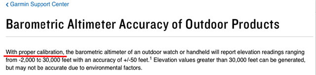

  • The information you provided GPS is accurate to +/-400 feet is not valid
    https://support.garmin.com/en-US/?faq=WlvNrOungC28xGtwB7hLY5
    Also that is not normal having unstable altitude and fluctuation...

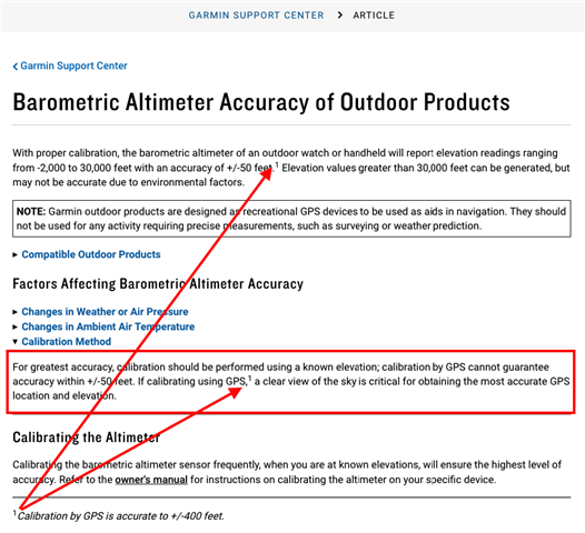

    Of course, my information is valid
    . Please refer to footnote (1) also in the support article you linked.
    Thanks for your link.
    With it you confirm my statement. The article even contains my statement twice :

    Further, the article you linked also says at the very beginning :
    " With proper calibration".

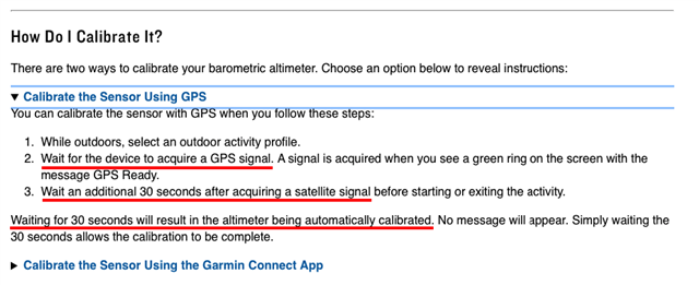

    What you show here in the video, however, is the calibration process ITSELF :
    https://support.garmin.com/en-US/?faq=LdBgVGQf0b9dILeDnsP189&productID=707538&tab=topics
    The moment you get the green GPS tick, it does not mean that the GPS reception is good.
    The green tick only means that you have GPS reception at all.
    For a position measurement without altitude information (2D) 3 satellites are required. If you also want to have the altitude (3D), at least 4 satellites are required.
    If you ever have the opportunity to look at a GPS device with info page, you will notice on EVERY GPS device that it takes a while until enough satellites are available to provide accurate data.
    In your video it takes about 30 seconds before you even have a green GPS icon. THEN the watch needs another 30 seconds (and this depends on the environment) until the elevation is calibrated.
    This also writes Garmin itself.
    In these 30 seconds AFTER the green tick, it is perfectly normal that the elevation must first settle.
    That's what your video shows.
    If you have seen other devices where this is not so, it may be because on these devices only recently a calibration was made, the altitude has not changed much since the last calibration, or the reception conditions were significantly better.
    I have already described the error tolerance in GPS elevation measurement, and you have confirmed this statement again with your link.
    If you still have problems with the calibration, I recommend you the DEM method via Connect Mobile, which performs the calibration according to topo data.
