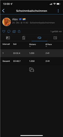

I have a problem when tracking indoor swimming sessions with the Venu 2. My old vivoactive 3 automatically divided a swim into 25/50 meter segments (dependent on pool length) and tracked personal records for intervals (100 meters/1000 meters etc.)
The Venu 2 should also do this, according to the manual, but just tracks 1250 meters as a whole without any segments. Also the SWOLF is way off. It calculated values between 50 and 65 on the old Vivoactive 3 and values between 100 and 120 on the Venu 2. I guess there is an error in the formula for 50 meter pools.

And this is the display on the Venu 2 for an almost identical swim:

  • I have never seen each length of a Pool Swim activity be classified as its own interval.  That is pretty strange.  Normally, the intervals consist of a number of lengths in each interval.  For instance, personally speaking, if I were swimming a 1,250 meter session, I would probably swim 5 - 250 meter intervals.  It looks like (in the first image on your Vivoactive 3) your activity broke up the 1,250 meters into 50 - 25 meter intervals.  That is not correct.
    In the first image on your Venu 2, your Pool Swim activity shows that you swam 1,250 meters with no rests.  In other words, you swam 1 - 1,250 meter interval.  Is that accurate?  If so, that IS correct and that IS how the app should be displaying the activity.

  • Hey Kevin. Thanks for your response.
    Yes, you may contact me by email and you may access my Garmin Connect account for further investigation.
  • I have the exact same problem with Venu 2S. SWOLF is miscalculated (in my case instead of 50m - time for 100 m is taken so the SWOLF value is doubled) and whole swim is treated as an interval.
