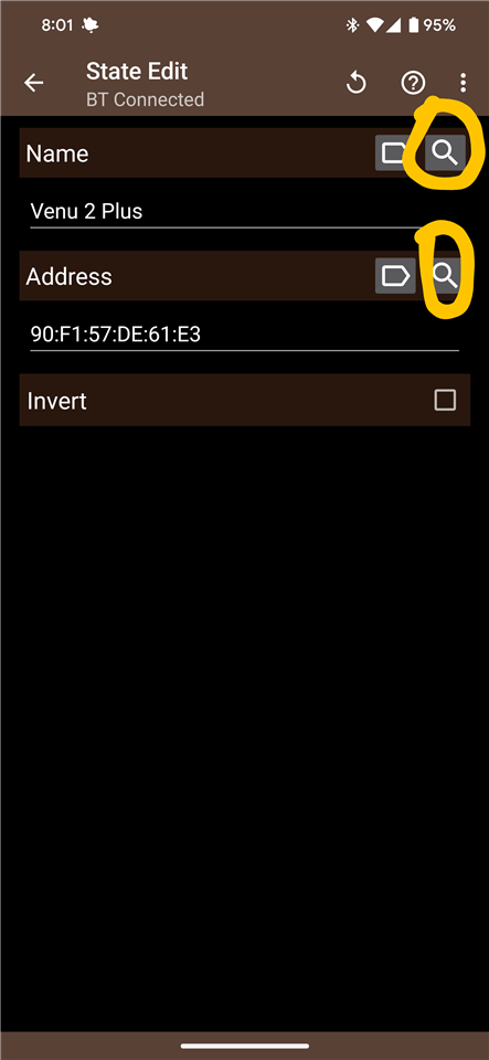

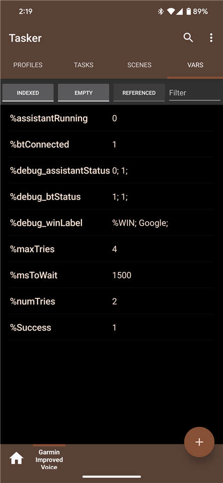

  • Ohhh I see the VARS tab is where you define your variables. I have not written any code since like 1988 and then it was all IBM MVS Assembler and COBOL. But hey I am ready for Y3K just call me LOL.
  • Thanks a lot for posting it on Taskernet. You've helped out quiet a few people already.
