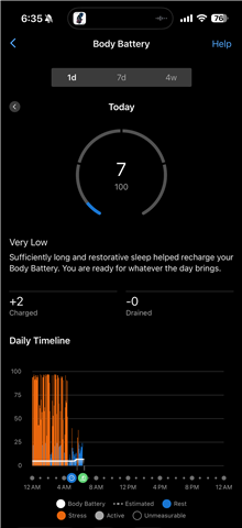

I am not sure if I can post all the screen shots but my body battery is not updating. Is have the ISM and the vivoactive 6 so it should supposedly be working after 12.70. It is fully up to date but it is the weirdest thing. My sleep score was a 95 and my body battery supposedly got +75%. But my body battery stayed at 5%. Any idea as to the problem? It also for whatever reason looks like I have high stress all night but the sleep report says I slept all night aside from a few wake ups.
  • Not sure if this will help but for my Forerunner 265 I have to let the ISM fully sync with Garmin Connect.  Then I let my watch sync with GC.  Sometimes I have to sync once or twice before my body battery will show on my morning report capturing the information from the ISM, and updating my body battery for after midnight scores.
