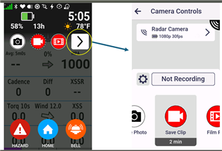

My new RCT715 got new firmware this weekend (6.x) and My EDGE 1050 no longer has a widget that lets me take a photo or video on-demand.
I can't find a way to enable that again. Seems like they accidentally or intentionally removed that?

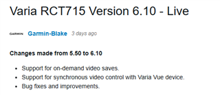

Strange - 5.5 had on-demand photo and video saves. 6.1 removed this.

The controls have now moved.
If you tape a training page there is now a short cut on the home page overlay
THANK YOU!!
