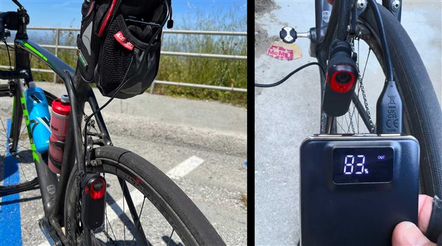

Confirmed RCT715 works with backup battery
Above you can see the setup; the RCT715 hooked up to a 10000mah backup (GETIHU BG-140) on a 4 hour ride. Set for continuous camera recording, and flash changing as cars approach. At the end of the ride the power bank had used up 17% of its capacity, while the RCT715 stayed at 100% charge.
My biggest issue is with the mounting of the RCT715. The seatstay mounting isn't secure enough; it will try to move inward towards the wheel on bumpy pavement. Not a good thing. Going to try to figure out how to use something that clamps on the seat mast and drop down, to put it "over" the rear brake.
  • I bet you’ll see third party options for alternative mounting options before long.
    The seatpost mount suits me but I don’t have a regular seat bag. I use a Silca seat roll fastened to the top of my seat stay triangle.

    I wonder if when the battery is at 100% and you plug in an external battery....   Do you think it takes power externally and bypasses the internal battery all-together to run the device?  Or rather, it keeps using the internal battery while charging it?
    The reason I ask is, if it doesn't wear down the internal battery and bypasses it, I could double it up as a dash cam in my car.   I wouldn't want to do this on a regular basis if it wears down the internal battery.  I'd imagine nobody could really answer this except for Garmin directly.
  • Do you think it takes power externally and bypasses the internal battery all-together to run the device?
    I'm not well-informed enough to have a definitive answer for this but I have my suspicions:
    This would be specified by the USB-C standards, not Garmin. If I were a betting man, I'd think USB-C is smart enough to shunt power from the external power source directly to whatever needs current and bypass the battery.
  • The possible issue with that bet is that li-ion batteries don't last long when they're always fully charged. If you bypass the battery completely, whenever it's at a full charge, a backup battery is going to cut into the lifespan of the internal battery.
    You would get around that if you let it float within a range. But is that really part of the USB-C standard, or a built-in power management chip like you have in a cell phone?
  • I'd say it was much more likely that the light would always run off the battery, and never directly from an external power source as it keeps the design much simpler and avoids unnecessary additional costs for something that would not be of any significant benefit. This tends to be a standard design, which is why most portable electronic devices won't run off the mains if the battery is missing or unable to hold a charge. You can normally test this on any device by letting the battery run totally flat (so the device won't even power on), then plug it in and try. Usually, the device still won't power-on until the battery has received some charge.
