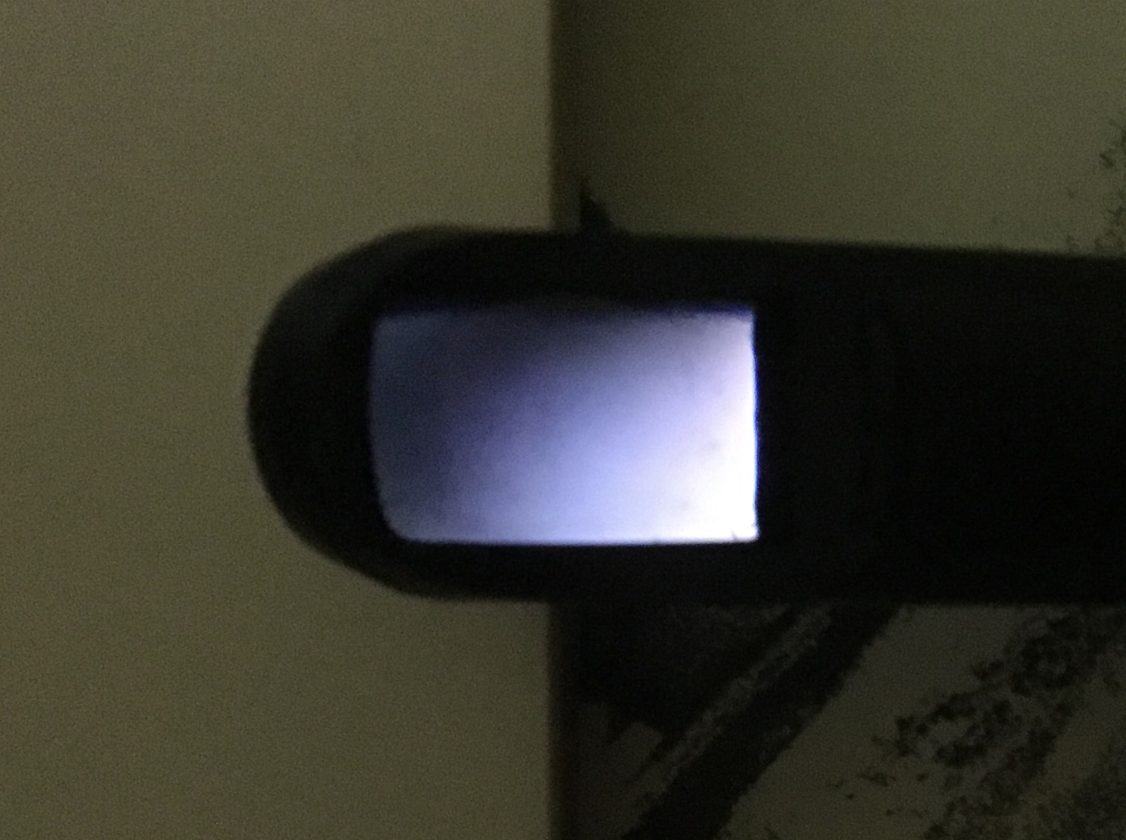

    I attached a pic of the Visions screen. When I turn it on, that‘s all I can see.ciq.forums.garmin.com/.../1456468.jpg
  • The fact that you have tried a reset and are still getting this issue does not leave you with many options. I think your next move would be to contact Garmin Support.
    When the Vision is connected to the PC it should show as device or drive. Could you post the GarminDevice.xml file that is in the Garmin folder on the Vision?

  • For some reason your vision is at build 3.50 and not 3.60. I wounder if the update is failing to load, which is causing the problem you are seeing. Have a look on the device for a gupdate.rgn file. It would be in the Garmin folder. If it is there delete it and see if the unit then starts. If it does you can try using Garmin Express to update it again.
    Your unit <SoftwareVersion>350</SoftwareVersion>
