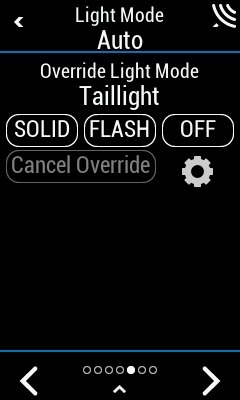

  • ...now it appears to work in both modes so I now have the battery status etc.
    JRat1 I realized that I did not have the Light Widget on my Edge Explore turned on. You might want to enable it if you have not. I've attached a screen shot.
    ciq.forums.garmin.com/.../1446332.jpg
