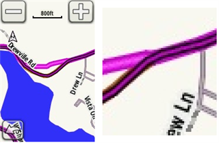

  • This isn't showing the recorded track, which is usually cyan (a light blue color).
    The lighter line is the calculated route.
    The darker black-edged on is the track from the course file.
  • Thanks, that shows the colors nicely, the OP, who asked the question in 2 posts (2 languages), seems to have lost interest as they often do, understandable maybe, seems anyone providing an answer is assumed to be a Garmin employee and therefore not due an acknowledgement, these forums are becoming less & less populated these days, maybe in parallel with the declining software quality, pity as I have learned much over the years from people like yourself.
