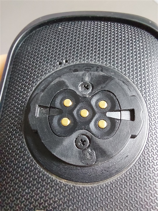

  • AFAIK / INNIE (ignorance need not inhibit eloquence?), The Explore 2 (Power) has additional contacts (5 gold colored metal pins) built into the quarter turn mount on the back of the explore and these correspond to contacts in the "Power Mount" which in turn correspond to contacts on the Charge battery pack so that the charge from the battery pack can flow through to the Explore 2 (Power) via the Power Mount.
    The standard Explore 2 does not have these contacts (or additional wiring from them to the battery etc)  in the quarter turn mount so can't accept a charge via the Power Mount BUT you could use an appropriate cable as I "think" the Battery Pack has a output port for charging other stuff and you can connect this to the Explore 2. I don't know  what connectors are necessary on the cable ends, USB A, USB Micro, USB C, ??

    This an 840 but same
