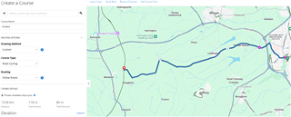

eg this is a route created by the website, 13.5km long and as direct as it can be
