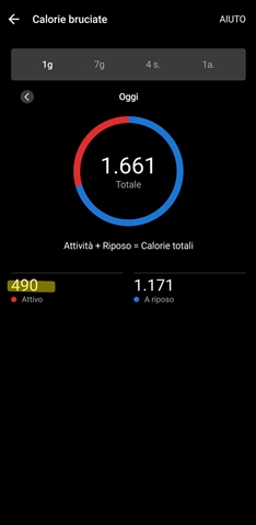

Hi everyone, whit my Edge 850 calories registration is not fully charged on Connect app widget, i use 3 different devices in my personal daily activities, TDA whit Tacx NEO bike, Fenix 8 51(SW 21.24)  amoled  in trail Running and runnig session, Edge 850(SW 29.22) whit Road and Gravel bikes.

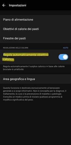

No other device made any mistakes in calories registration with Connect before, i also subcribed a Connect(+) registration and i actually daily use the new feature of "Alimentar Diary" useful for correct replacement of energy spent on the way. If my Edge is not able to comunicate the correct amount of energy spent how can make the right alimentary choices for my preparation and health balance?

  • Thanks KC. I’ll adjust my settings registration anytime I go out with my bikes. I’ll try switching my Edge to the primary training device before any run. In the meantime, I’m checking that Physio TrueUp is enabled. I could try leaving my watch at home or disabling physio registration during pedaling sessions, but it would be a bit frustrating for me to disable and enable something every time when it could be handled automatically by the devices under different recording conditions.
    New SW 30.18 downloaded and ready to install. I’ll notify you as soon as I have news.
