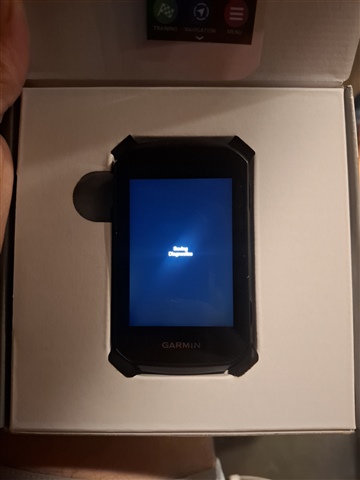

While updating to FW 29.22 unit goes into "saving diagnostics" loop. Any advice?
Hello,
I encounter the same problem actually! It helps not to press RIDE but do the start from the timer start/stop button.
Of course, I also would like a general solution to the problem.
Any ideas? Thanks in advance
EP
Same with me. Looping in saving diagnostics after firmware update. Absolutely new device.
Update: factory reset ok. Power+lap+start for long time
