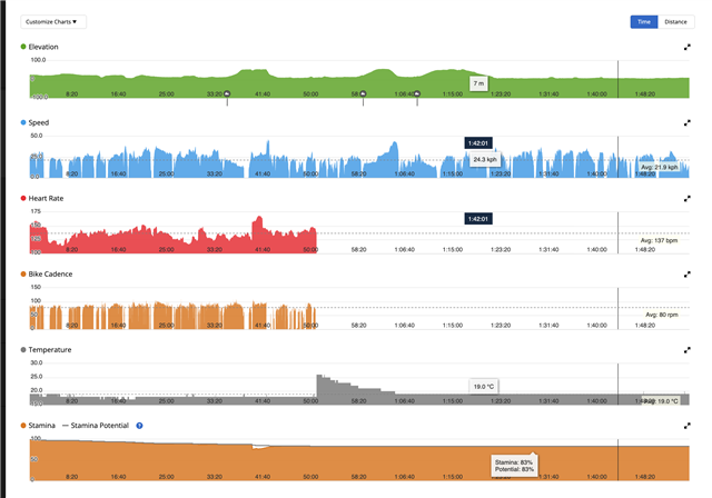

    I was at a bike shop paused my edge 850 using the bottom right button.
    Then resumed recording and noticed my Garmin-Cadence-sensor and Garmin-Forerunner-HR-Broadcast-watch did not connect, after I finished my bike ride.
    I am on firmware 7.10
     Link to my activity: connect.garmin.com/.../20525514135
