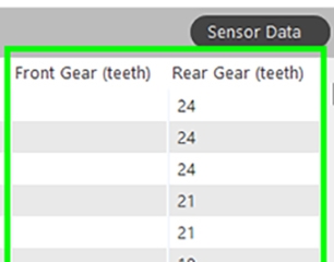

  • As an update on this the attached picture shows the live Di2 data screen on my Garmin Edge 840 whilst the Shimano Deore XT M8200 Di2 wireless MTB gears are connected.
    The live display data screens show both a Front Chainring present and the correct chainring size of 34 tooth front chainring x 39 tooth rear sprocket (manually entered front chainring size in sensor details).
    The .fit file however is only recording the Rear Gear and the Front Chainring data in the .fit file is invalid.
