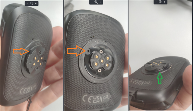

  • so , pls check these: (orange arrow for the baro's hole, green arrow for the right assemly direction ,avoiding to install back upside down)
    i think this hole got dirty (moisure in this hole or around it through the summer) and this is why the raw datas in the fit file got flatter and flatter elevation profile (it is a sign of the moisure in this hole) and not the calculation method or something else the problem. so unscrew that 2 tiny screws, blow out that hole multiple time, install back and re-try.
    one more question, do you use any rubber case on it or what kind of mount do you use and where on the bike (stem, front mount, etc)
  • i have checked that hole multiple times and i haven't really ridden in wet conditions. But will check again to be sure, i don't have case for my computer and my computer sits on stem.
  • the high humidity is enough for that, or the stem position can collect and hold the sweat easier , harder to dry out comparing to a front mount for example.
