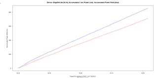

  • Something is impacting the radio reception rate. The power meter is low at around 83%. Anything below 90% power meter will impact the data. The HRM and speed senser are also low. Do you have a camera or something mounted close to the Edge.
    This explains the power difference. The Edge records one second power. It also records accumulated power as transmitted by the power meter. If data is lost due to a low RX rate then the sum of the 1 seconds values does not match the accumulated power values.
    The Edge uses the accumulated power values to compute average power, while Strava is using the sum of the 1 second records.
