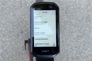

    sensor menu, there is the Cycling Dynamics submenu (yes, i know it is a 1050, but in the 840 is the same):
    and there is the toggle for CD and for the TE and PS , both must be ON

    Your Edge must be connected to your pedals as if going for a ride, then:
    From the menu select Sensors for your Profile.
    Select your Power Sensor(s) (Favero)
    Select Sensor Details
    Select Cycling Dynamics
    Switch Cycling Dynamics to ON
    Switch Torque Effect Pedal Smth to ON
    Assuming you have Torque Effect & Pedal Smth Data Fields in your power Data Screen you should now see the metrics.
    May need to do the above for multiple Profiles if applicable.
