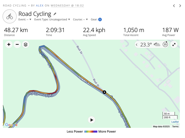

I'm doing a 20km climb at a 5.5% average gradient, categorized as HC. The problem is that the climb is constantly interrupted by intersections, even though I'm not deviating from the climb route. This is likely happening due to a loose GPS signal or a lack of quality in the map data.
For example it false detecting climb end at this intersection at 70-80% of tries (activity)

    It's crazy, but the climb ends early even if I'm riding a segment marked as a favorite, which fully matches the climb.
    At the crossing where climb randomly ends I can't see any GPS anomalies. You can see it by yourself (image is attached above). Maximum accuracy not worth it as the ride is long enough and i don't generally care about Climb Pro. But this feature is unreliable. GPS mode is set to auto btw
