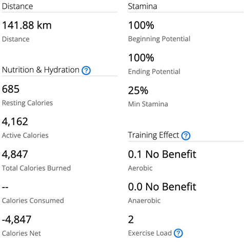

Then after I saved and synced, i noticed on my Garmin watch my training status is "Recovery".
Went in Garmin connect, sync/reload everything again. Still the same.
Just had a look on the web and turn out none of the data under 'Training Effect' is there. (Wtf?!)

2) why all data is there, except for the my Training Effect data
3) any way to recover the data

  • Unfortunately, I have noticed this phenomenon with Garmin products since the days of Fenix ​​5 and Edge 1030. If the device is restarted, the calculated score for Training Effect is close to 0.
    I haven't found any solution for this.
    The calculation seems to be somehow in a variable only in the volatile memory of the device and nothing stored, so that on restart it can return to where it was.

  • Training load, hydration/sweating, calories and probably some other minor stats are not stored during navigation into the fit file.
    These stats are saved only when you save the activity after ending it. That's the cause of training load being 0 after restart. I had this issue with 820, 830 and 840.
    You can't recover the data, it's lost.
