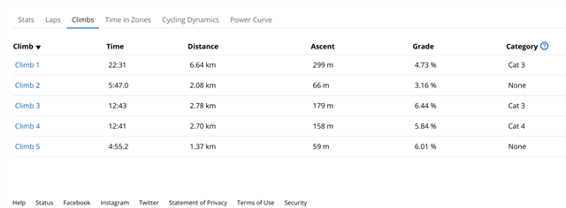

[BUG 9.29] Climb Pro does not record the actual climbs in the activity.

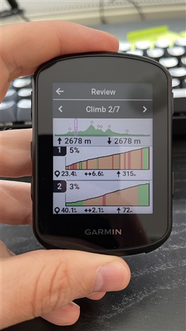

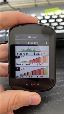

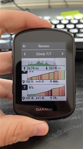

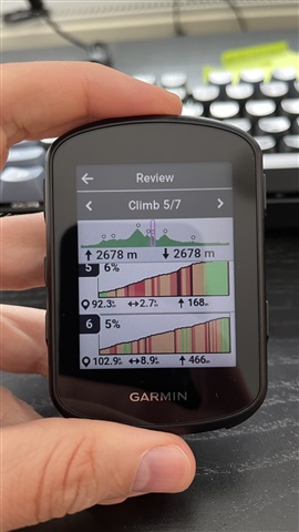

All 7 climbs were successfully completed, and for each climb, a separate data screen with a colored gradient graph appeared and was displayed. However, not all of them made it into the activity in the end! The most challenging and longest 15-kilometer climb was not recorded, second essential 8.9 was not recorded...
And now I cannot retrieve the stats of them. :(
