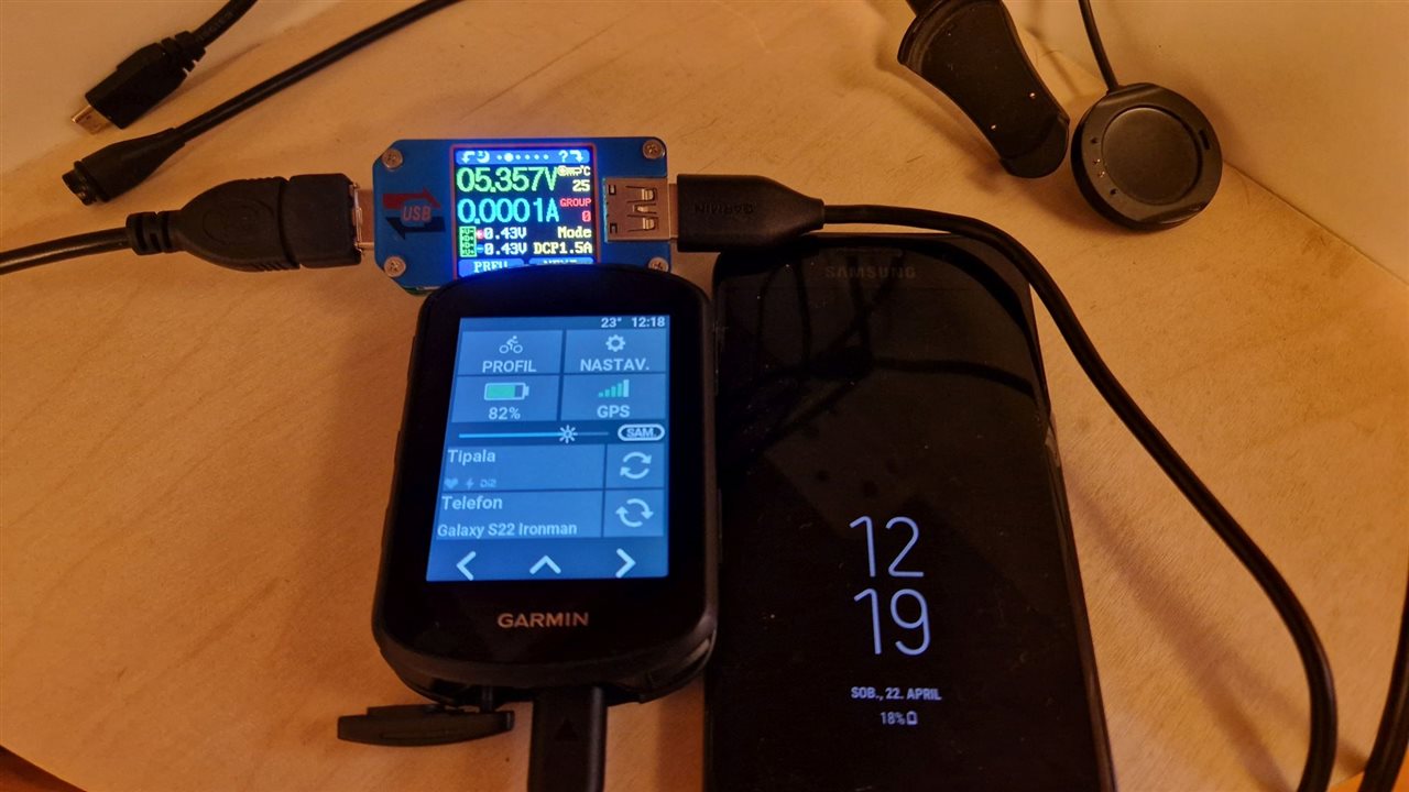

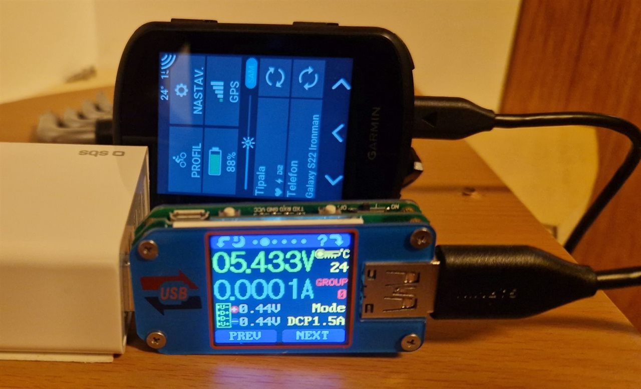

When I connect it to one of my multi-port chargers having specification of 2.1A output per slot (with nothing else connected to it), it does NOT charge the Edge 840. It doesn't even make a beep when connecting the cable.

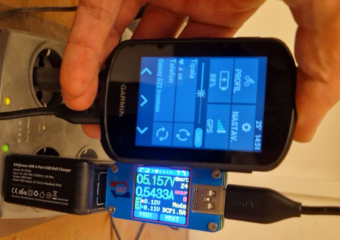

  • My 840 arrived and it's charging at 5V and 500mA, just like yours.
    I did a little google on DCP1.5A, turns out a lot of chargers support it.  I couldn't find the spec, so I'm claiming it as "Dave's Charging Protocol 1.5 ampere".  It's interesting that your meter thinks the 840 asked for DCP1.5A.  Could be a charger firmware bug that preventing the charger and the 840 from agreeing on charging parameters.  Could be a bug in the meter firmware just throwing us off the trail.
    I did see one post where the charger did not switch to DCP1.5A and therefore didn't charge the device as expected.  That's the same experience you have.  Unlikely we will ever know exactly the problem.

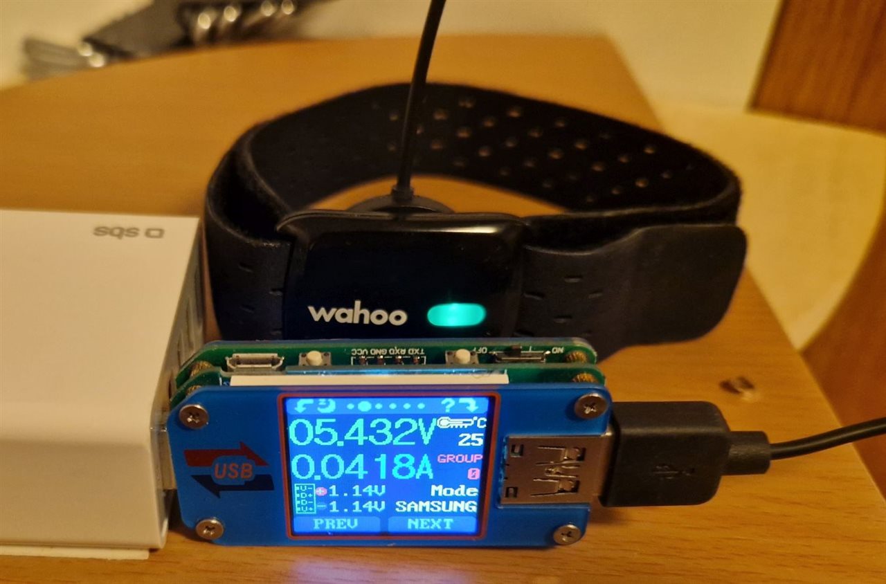

  • Interesting - that it is Ravpower charger which is giving you a headache. In my case, it is the other way around... it is Ravpower charger (the black one) that actually works. It's the SBS charger (the white one) that doesn't charge the Edge 840. So, it looks like it doesn't simply come down to the brand, but it may be more complicated.
  • Thanks for sharing. Ok, now we at least know that 0.5A is the normal/expected charging current for the 840.
