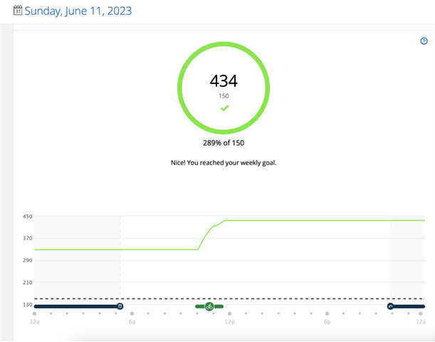

Intensity Minutes from 840 not counting
I did my first ride on the Edge 840 today after coming from a 530. It is reporting 81 total intensity minutes for the week but Garmin Connect and my Fenix 7x still only shows 29 intensity minutes. I have the 7x as my primary wareable and training device. I’ve tried switching to the 840 for training device and still shows the 29 minutes. I thought this was all suppose to sync with the new devices?
  • After riding a couple times on the MTB without my Fenix 7x I am happy to report that Edge 840 intensity minutes do count towards the total in Garmin Connect, but only when not doing a workout. A bug still exists when doing a workout the intensity minutes won't show.

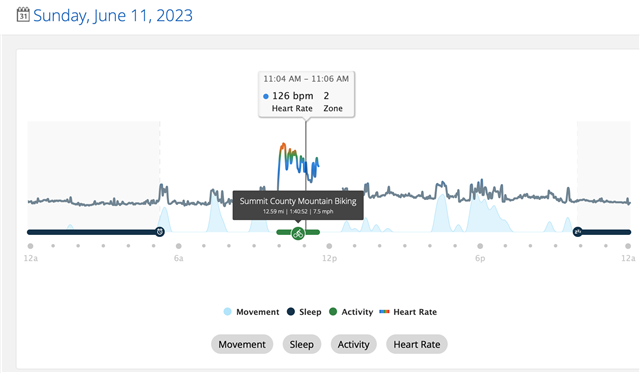

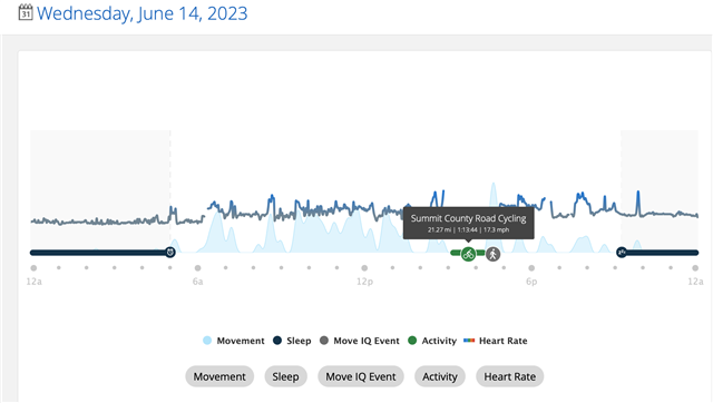

  • Experienced a new issue yesterday. Did a normal road ride, no workout, just a simple course like I typically do. Avg heart rate was 152, Max 180. Intensity minutes calculated on my 840 but Garmin Connect is not recognizing them and the activity does not show it in the stats.
    I have compared my rides where IM from my 840 syncs to Garmin Connect to those that it does not. It seems that when it does sync, my heart rate is recognized while riding in my daily heart rate graph.
    Any time the ride on my 840 doesn't sync with GC, my daily heart rate shows the little activity icon from the activity, but shows missing HR data.
    Again, I do not wear my 7X solar while riding.
    Sunday: IM from 840 worked
    Wednesday: IM from 840 didn't work
