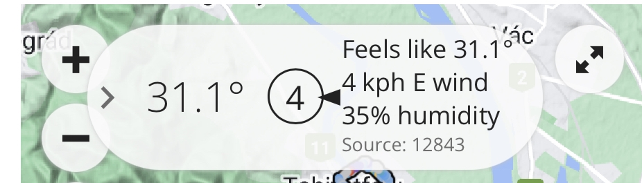

    Exactly as I did. If I had not done this way GC web would not be able to show weather data assigned to the activity. It assigned 31.1 C degrees, which is 88 F. I checked and the weather station provided humidity, too.
    So everything happened as in all the early cases when relevant Heat Acclimation was calculated and not 1%.

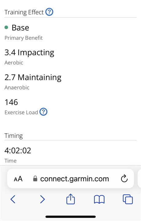

    And it was not a fake ride of 5 mins without any training effect:
    And I do not know from where this value of 1% comes. Is it the remaining part of a higher value gathered by wearing my F6X, or that of an earlier ride made a couple of weeks ago with 530? As I wrote in the other thread one cannot check the historical chart of Heat Accl. of 530/830 if it is not his primary device.
