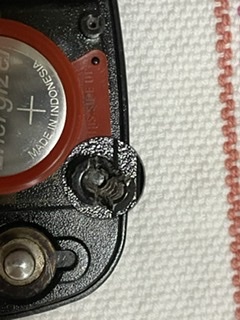

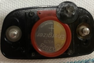

  • I found that my issue was with the HRM. It went dead.
    there was a time once that I had to replace the battery. When I opened to put the new batteries, the screws wholes dried up and never fully isolated the unit since then.
    See Pics below.
    I believe the sweat/rain water/water splash entered the unit and burned the circuits.
    I got a HRM from a friend and it is working fine.
    Good luck with yours,
    Romero
