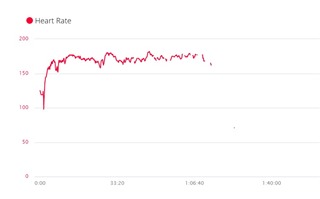

The last time I used it.. It paired so quick like always but at the first moment it showed “_ _ _”.
Every 20-30 min it shows me a single reading and then quickly goes back to showing” _ _ _”

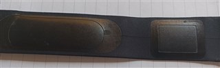

 I’ve attached some image of the strap itself and the module and HR graphs.

    same happened to mine in the past week or so, contact pads on the strap started peeling off, so i bought a brand new strap , with new batteries, no Bueno..

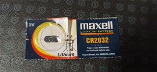

  • Thanks mate ... I don't think the battery is the problem as the problem started with the first battery then I changed it with a new one but the problem has not been solved ... however I checked the first battery with a special device which said just 50% of the battery has been used!!! here is the batteries I used ... first Panasonic  ....second Maxwell
    The first battery
    and Then I changed it with a new one

  • Mine is okay  ... not worn out yet as you can see on the picture .... I'll do whatever @Garmin-Blake said then let you know if it works ... ...     I wonder why it should be like this after just around 6 month!!!!    I hope I can find a fix ...otherwise I'm not gonna buy Garmin ....
