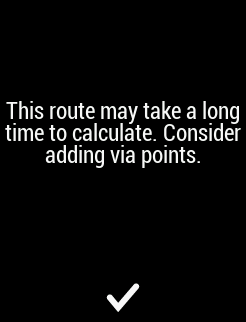

I was recently navigating a mountain bike route I had built in Trail Forks, but the route was not taking me where I had expected it to.  So I decided to bail on the route and tried to navigate back to start.  I selected "most direct route" and it popped up with a message "This route may take a long time to calculate.  Consider adding via points."  I thought that was strange, because I had ridden only a few miles at that point.

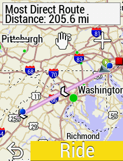

I tapped the checkmark anyway, and here's the point it took me back to:
But here's where I actually was, trying to get back to my start point:
Why did the Edge try to get me back to a point over 200 miles away?  Interestingly, that is a point on another route I have saved on my Garmin.  So it is confusing routes somehow.

    After ending navigation, I simply selected "Navigate back to start."  I did not drop any pins.  I started this ride from the start point shown in the third screenshot above.  Why did the Edge navigate back to the point it did, instead of where I started the activity?  That location was from a ride I had done weeks ago.  I've done probably ten other rides since then (starting them and stopping them when finished).
  • The problem you had was that, somehow, the device thought the start was a very long distance away. The "too long to calculate" message was the result of the weird far-off start point.
