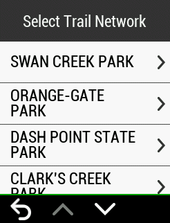

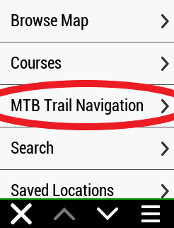

I'm interested in riding a local (<50 miles away) MTB trail system that I haven't visited yet.  I tried to pull up the system on my 830 Navigation/MTB Trail Navigation menu (screenshots shown below).  But when I get to the list of trail systems, the list displayed is near the Tacoma, WA area where I visited many months ago.  I'm now as home in central Indiana.  I can't for the life of me figure out how to get a listing of local trail systems.  Help please.
  • I suspect that the problem is that you don't yet have a GPS lock. Looking at the first image you posted you can see that GPS has not yet got a lock. It is likely using your last know location until it gets a GPS lock.
    Try getting a GPS lock and then do the search.

  • , I have used my Edge numerous time since returning from Washington in my local area and certainly have achieved a GPS lock.  I am still stuck with the trails list from Tacoma, not Indiana.
  • Former Member, I am not paying Trailforks.  So maybe that's an issue?
    I used Basecamp to review the Trailforks map (2021.10) loaded on my Edge.  And indeed, the is a large chuck of Town Run missing North of 465 and a bit south of 465.
  • Finally figured out a work around to view local trails.  I had to select one of the trail systems in the current Trail Network list to get to the map.  Then had to drag the map to my location, and select the "Use" button in the lower right corner, select the check mark to navigate to the new location, ignore the "No routes found..." message, hit back arrow, reselect the MTB Trail Navigation menu item, and a local trail network listing shows up.  Very convoluted and non-intuitive.  Don't understand why a list within the GPS location doesn't populate.
