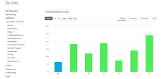

Nothing about intensy minutes, nothing about the faulty physio true up. The device will remain in the box.
intensity minutes have nothing to do with Edge 830, it's part of a Garmin watch…
and True Up without Physio is something different, if you have multiple activity trackers (Edge isn't a Activity Tracker):
