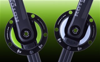

 Apologies if this has been asked before (I couldn't find anything specific about it) but I cannot get wattage from the crank into the 830, any ideas?
The sensor connects ok, I add *every* screen value related to power I can see, I calibrate it but nothing ... When I upload a ride to my phone afterwards it picks up the cadence, so I know its talking to the 830 ok, but just not sending the wattage, unless of course it's being kind to me by showing a zero instead of my real value!!

    It is a new NG, it came fitted to the Cannondale, but I registered the red label thing in the NG App, that seems to be ok - The app says I'm registered and it can talk to the crank. Through the app I have done a factory reset and reinstalled the latest firmware.
    The 830 picks up cadence (though I dont ask it to, but it always appears in my strava) so I know that part of it is working; I have swtiched between ANT, BT and both, it says calibrating successful (usually flashes up some numeric value 0.8xxx)
    After I add the sensor in the 830 I follow the script and add every power value I can to the screen, I see the cadence value, but power continues to read as 0w ...
    Do you think my crank is broken? I cant think of any other reason!

    Silly question, but is the NG paid with the bike or not? because there are bikes with preinstalled NG powermeters but not working until You pay for it to the P2M, probably until it shows only cadence but not power.
  • Former Member
    0 Former Member over 5 years ago in reply to Luko79
    ah! ... hang on....power upgrade on the app, never knew that was a thing, I'll try that!
