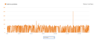

Hello, I'm having an issue with the Cadence Sensor 2.
I reads fine the values but at any ride, give me the maximum rpm extremely high (a kind of peak).
I'm uploading two images to describe better. Thanks!!
  • This cadence sensor is based on an acceleration sensor. On a relatively steady road it will trigger once per crank revolution, but on a (very) bumpy, hard road it can also get triggered by a bump, leading to such peaks. It can also be that at a certain point you peddle backwards e.g. for a quarter of a revolution and then quickly again forwards, producing 2 successive triggers in a short time - again a peak.

  • Thanks a lot... today it did it again. Actually it does at any ride Neutral face
  • , the Garmin speed sensor 2 contains indeed a magnetometer measuring the 3D components of the ambient magnetic field, and can like that see when it makes a full rotation - see https://support.garmin.com/en-US/?faq=9NL91YJSJd3Tnyif9jRSy6.
    But I'm still convinced that the cadence sensor 2 is an "ordinary" accelerometer. Not only because DC Rainmaker says so (https://www.dcrainmaker.com/2014/05/garmins-spd-cad-magnetless-sensors.html), but taking also some "experimental evidence" into account. As I had noticed myself similar spikes with that cadence sensor, I did some tests and have seen that the cadence displayed on my 830 occasionally jumped to values well above 0 exactly after hitting a bump on a downhill paved road while I definitely didn't move my pedals at all for several hundreds of meters. That surely points in the direction of an accelerometer ...

  • The cadence sensor uses accelerometers
  • Thanks all for the reply... It just a shame to don't have accurate measurements... Thanks
