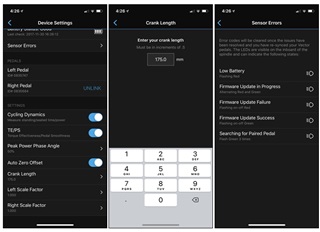

  • Luko79 wrote:"....the Edge overwrite the preset length in Connect app, so need to set it in both, ...."
    Where is the crank length in the Connect app?  I don't find any sensor related information in the app.
  • if you have Vector 3 you can pair them with BLT to the Android App and you are able to configure crank length, but for security reason i removed the v3 there, cause otherwise they are connecting to my mobile phone when i ride and have y mobile phone with me
  • Where do you find "Device Settings"?  Perhaps I would need to have the pedals paired with the GC app to see that?  I don't do that.  I only pair the pedals with the my Edge units, or PC/tablet for Zwift, Trainerroad, etc...
