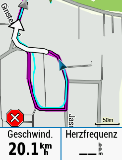

currently I'm using beta firmware version 5.26 and I notice two issues that occure for some months:
1) the symbol showing my current location on the map is 5 - 20 meters behind my real position. This is annoying since I miss the right turn from time to time. Am I riding too fast? :-)
2) I create courses using komoot on my PC and use the komoot app to download courses to the Edge. Following a course I see the white arrows indicating turns - but the large overlays which are normally displayed 150 - 200 meters before a turn don't appear any more (since some months and some firmware versions). I checked navigation options several times and I'm sure this issue is not caused by incorrect settings.
