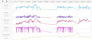

    This is a view of data collected during this ride, as you can see there were 2 quite long stops. After the first stop, all sensors reconnected but after the second stop the Powermeter (including cadence) did not reconnect.
  • Former Member
    0 Former Member over 6 years ago in reply to Former Member
    And the issue was not the battery of the powermeter as I had in parallel a second bike computer (Wahoo Bolt) and it recorded correctly power and cadence during the whole ride as you can see below:
