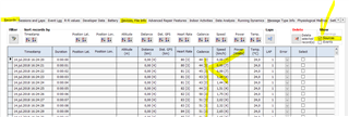

    hi,
    forgot to ask, did you remove and repair the sensors ?
    Fit File Repair Tool can show something like this
    in tab "records" select sources and it shows you a number after the value
    that number corresponds with the sensor you will find in tab "devices file info"
    happy & safe sporting
