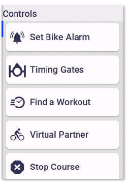

Is the function Virtual Partner available on Garmin Edge 550?
I don't know how to use it. On my old EDGE520 it was very simple.
Does anyone know how to activate the function?
The menu item to activate the VP gets added when a course is selected and "Ride" picked.
There will be an entry on the controls widget in the widget loop.
From the home page use the up button to entry the widget loop. Then advance to the control loop
