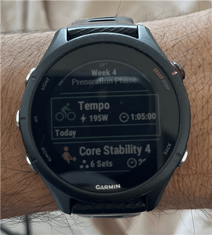

About 2 weeks ago, I recommitted to a Garmin Cycling Coach plan (after spending some time on TR). All workouts would sync beautifully to my forerunner 255s but NOT SYNC to my Edge 540. After lots of frustration including my troubleshooting steps below, I finally figured out that the reason was that I had "Strength Workouts" enabled in my cycling plan; only when I turned Strength Workouts off was the Garmin Coach widget restored in my Edge 540. And yes, the workouts are slightly different. And yes, this is annoying.

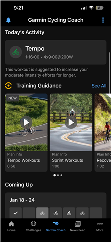

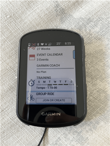

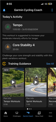

Garmin Coach Plan w/ Strength Workouts - Bad Sync

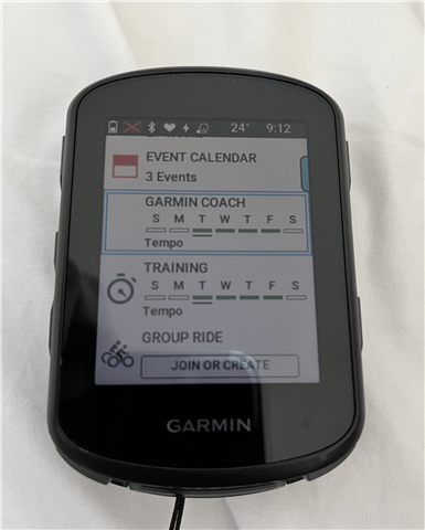

Garmin Coach Plan w/o Strength Workflows - Good Sync
