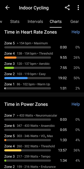

Ok, let's check this further - are you getting some of your rides in HR Zone 3-4, like below?

Ok thanks. Here I see the root cause - Edge sees all your trainings are in Zone 1&2. But in order to be able to calculate VO2max, your training needs to include Zone 3, for at least 15 mins in total per ride. Such is the algorytm in Edge. Then, based on VO2max, or rather I say "Performance condition" measured in such kind of a ride (it has also its geaph in post-ride report in Garmin Connect), Edge will estimate your Training Status (as Productive, Maintainig, or Unoroductive).
However, before you start hitting HR Zone 3 I suggest you make sure your currenr HR Zones are not too much off (200 bpm looks very off to me, unless you're 20yr old, or a professoonal competitive athlete). It you suspect it might be off, try setting your Max HR manually on device as 220-minus-age, for a start, and then turn Max HR auto-detection ON, so that Edge can auto-adjust it during your Zone 3-4 rides based on internal HR metrics it gets from your pulse.
