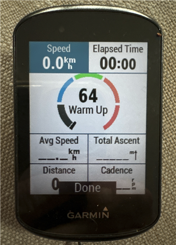

This is the current layout of my data fields on my Garmin Edge 530. Is there a way to move the large HR data field in the place of the two smaller data fields at the top? I've tried swapping fields, but the large tile remains where it is.
You cant modify the layout, the wide datafield cant be on the top.
I was afraid that might be the answer.
it is the same on 840 too (and i assume on 850 also)
Just use the "HMs DIY" app in the "Connect IQ store and create your own data pages,
I never use Garmin data pages these days and prefer to create my own, what you want would be simple to do
Connect IQ Store | Watch Faces and Apps | Garmin
This looks very interesting.- time to learn new skills!
It's not hard, look at the examples, select one and just modify it I find is the easiest way. Also, everytime you do something, no matter how small, get into the habit of doing a "Save", the app does have a bug in it that causes it to crash and you lose your work. But, the app starts up very fast and it will be where you left off.
