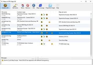

  • I can assure you that I have got 2025.10 and 2024.20 on my Edge 530 and the EU Topo maps do not need 10GB. I have looked at my device using JaVaWa and it informs me:
    Europe Topo East       2.8GB
                         Central   2.7GB
                         West      2.7GB
    Europe West 2024.20    2.6GB
    It has not installed 2024.20 Europe East and Central
    And Coverage is also complete for all the maps as I can also check that
    And I have two other smaller maps installed and I still have 1.76GB free

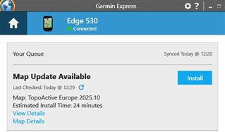

  • I'm starting to get really sick of this Garmin Express wanting me to update my 530 to the Topo Active Europe 2025.10 map. Everytime I connect, its wants me to upgrade.
    I upgraded Thursday night, went for a ride Friday morning, reconected at 12:00 to GE on my return, it wanted me to update again which I did as until I do, I cannot use GE as the notification masks out the "Synch" button"
    Today, I have not done a ride because of inclement weather, just connected to GE and once again, I have to update, I have not even used it since updating the day before. This is completely wrong.
    But, I see what might be wrong, when I look at the "View Details" of the map update in GE, it shows me what map is going to get updated
    But, when I look at the "Map Details" just below, only "Trail Forks" is listed. no other map, there is no mention of Topo Europ 2025.10, so is it possible the map itself is not registering into the 530 correctly into GE, so therefore GE presumes it does not exist and I need to reinstall and update it everytime? Seems logical!!!!
