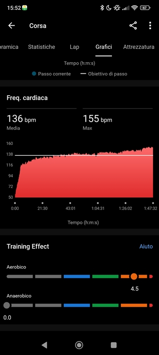

It almost always happens to me that the HR detection carried out via Edge 530 is absolutely discontinuous compared to what I get from a running activity recorded via Fenix ​​6. I don't think it's the battery since I have verified more activity over the last few weeks, running always perfect, intermittent cycling. Do you know what the reason could be? Obviously when I go out cycling I have both the Fenix ​​and the Edge, but the activity is only recorded via the Edge, could it be that I have to remove the band from the Fenix ​​to avoid creating contrasts?
I always use an HRM dual Premium, never the wrist sensor

  • You are right but I implied the use of the chest sensor, I don't trust the wrist sensor. The graph and all the comparison are made with an HRM dual premium: never had problem during running activity registered by Fenix, always had problems during cycling activity registered by Edge 530
