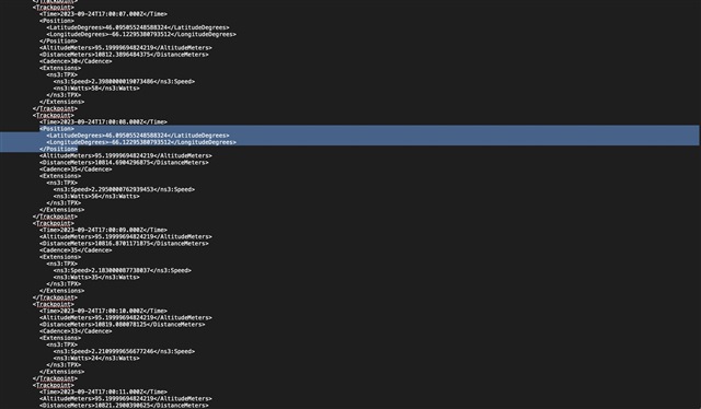

You can see here where the position data is dropped suddenly. Any ideas?

  • OK. I don't think it's a simple loss of GPS signal, otherwise there would be a straight line on the map filling in the missing data. Something else has caused the problem. Posting the actual fit file might provide more clues.
