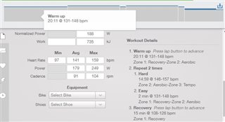

I have a little problem with "Set Target Power" option and smart trainer.
I have TP connected to gramin connect. There is a traning based on my bmp - so I must manually change the targed power on Edge to have declared value of bmp.
Problem is when I trying change power target during activity I'm start changng not form last set value but for value on that I finish last "lap".
Eg. first part "Warm up" I set 140W and value is ok. When I have part "Hard" I changed value from 140W to 200W. After few mins I see the bmp is to low so I try change again power. When I try do this I must clicking value agin form 140 to eg. 220 (not from last used power 200W). This is also reverse when I try decrease value. When I finnihs part "Hard" on 230W and I try set less value to 160, adn afeter few mins to 140 i must do this from 230W. Thi is very frystating beause I have sudden power surge and clickin from eg 230 to 130 take some time..
I'm using "TACX Flux S Smart"
Example of activity.
Below image with the power during activity, I marked o yellow pleace when I tried change the power.
