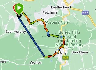

I missed a turn halfway through my ride but knew of an alternative route to get me back on track and was happy to put in an extra mile. For way too long, the Edge 530 bleeped, telling me to do a u-turn, then it just started a new ride and took me home. It acknowledged that I had somehow got from the starting point to the midway point but just mapped it as the crow flies.
See the attached comparison between Edge route and Strava, which I had running on my phone.

  • Thanks. Any idea what happened to the first half of my ride?
  • The straight line would suggest that there was no GPS signal lock for that part.
  • That can’t be right as it did direct me accurately the entire way. I just missed the turn.
    Thanks
  • You can stop navigating / abandon route at any time of your ride. Press upper right button and then "Stop course" (or something like this, I have my Edge in different menu language than English). It will cancel road you navigate however ride data will be still recorded like usual.
  • That's weird. The straight line indicates that there is no recorded position data in the activity file for that section or it is corrupted.
