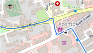

The blue line is the route i've created.
But when I'm nearing the corner I see something like this:
A zoomed in version of the corner, a IN 00:05 seconds in the right bottom corner. And the purple arrows shows how I need to go.

  • What do you use to create your routes?  If the map data in the route planner you use doesn't match the Garmin map data it can cause issues.  Use OSM maps in your route planner to avoid this.
    Also make sure when you are planning your route you don't put any control points directly at junctions as that can cause problems as well as it can cause overshoots.
    If the roads you want to use at the crossroads are slightly offset then the Garmin will tell you to turn right (in the pictured scenario) and then left.  If the offset is very small the Garmin often doesn't have enough time to show the second direction prompt.  Hopefully you can see the joggle on the map screen.  Sometimes they zoom in too far at junctions which could make this harder to spot.  The latest firmware has hopefully sorted this but I haven't had enough testing on that to see if has happened.

    Pinning route controls in or very close to intersections will give unpredictable results.
  • I just tried a route going through your first example (with York Road) on my 830 and the navigation prompts are correct and the symbols are correct.
    The maps are ones I made myself.
