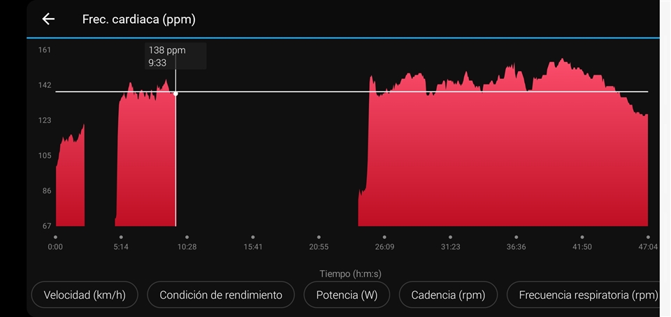

1st Graph - Pro Band
2nd  Graph - Pro Band after removing the strap
3rd Grap - Venu broadcast after be unable to connect the strap
  • Only one graph is showing. Given the propensity for 530 (and 830/1030) to drop connections, I would suggest its the 530 side of the connection which is the problem. Yes, people have had this problem before (including me), and yes you can send debugs to Garmin for them to do whatever it is they do apart from fix the problem.
