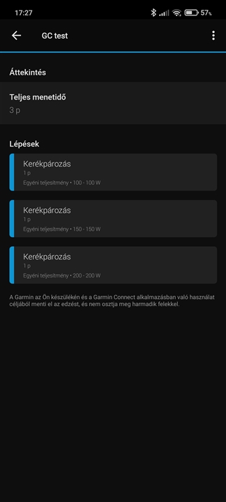

  • I use only Vortex for my setup as Garmin said without Assiomas, so power source is from the Vortex. It is the same, i did 2 videos, 3 interval and target watts always 106 watt.
    NOTES FOR GARMIN: I DONT HAVE TO CONFIRM 106 WATTS TO MAKE IT ACTUAL TARGET, I JUST PUSHED CONFIRM ON VIDEO TO SEE THE POWER LINES.
    https://youtu.be/ZzpuCGiuy2I
    https://youtu.be/FNRsCiFF2tY
  • I paired Vortex as power source ( so without Assiomas paired ) and the it is the same:
    Check the video please, Vortex produce 106 watts perfectly and then next interval is 160 watts, i wait until Vortex goes up to 160 watts, perfectly works then i go into Power target menu and it is 106 watts:
    AND I WAIT PURPOSELY 20 SECONDS AFTER GO INTO POWER TARGET MENU AND I DONT PUSH ANY BUTTONS = SO PLEASE NOTICE THAT 106 WATTS TAKES ACTIVE IMMEDIATELY AS LOG INTO POWER TARGET MENU.
    Then i go back and you can see the power curve, target watts always change to 106. Two problems here:
    - inaccurate power target in power target menu
    - power target takes active immediately as log into power target menu with that inaccurate target
